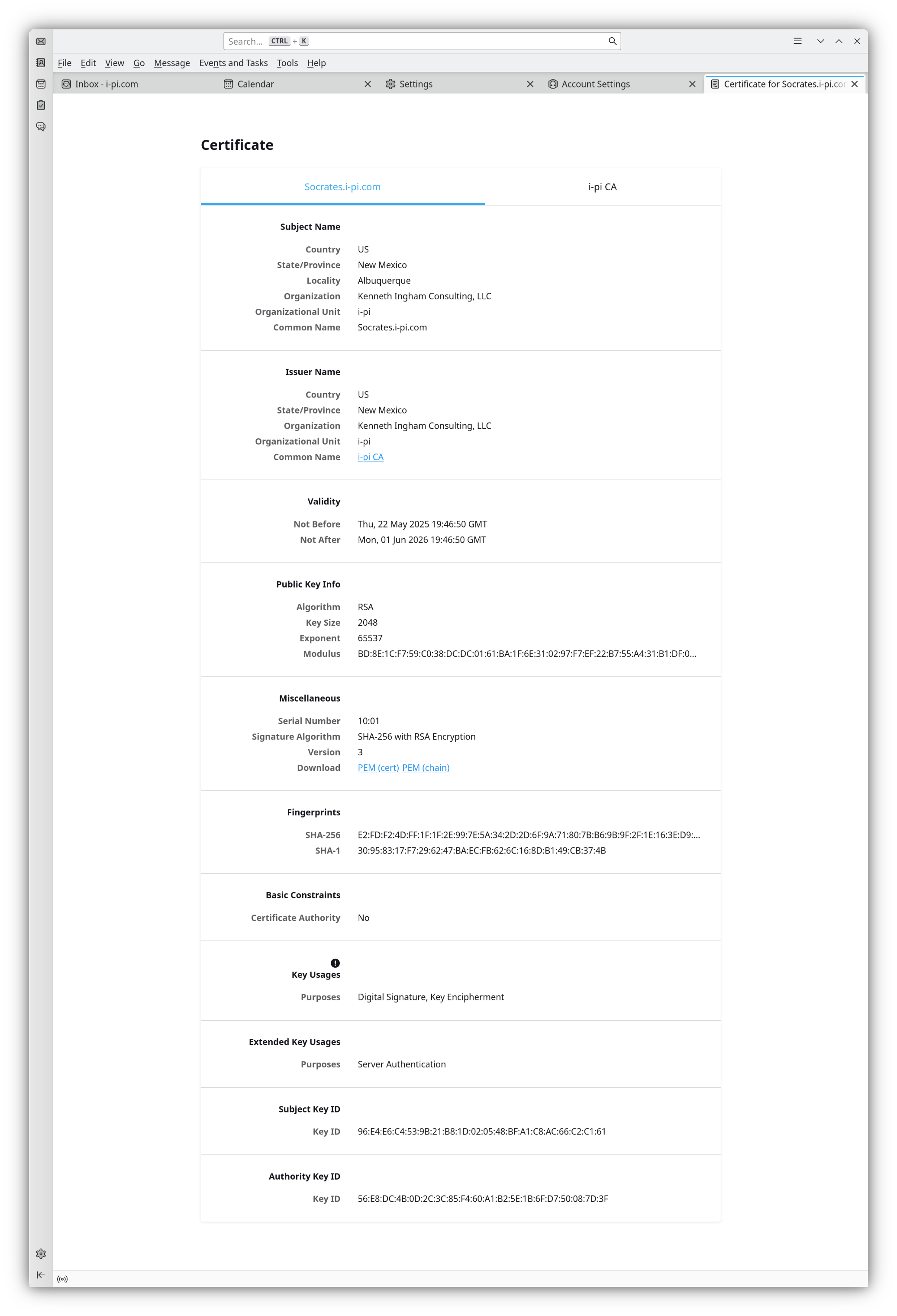

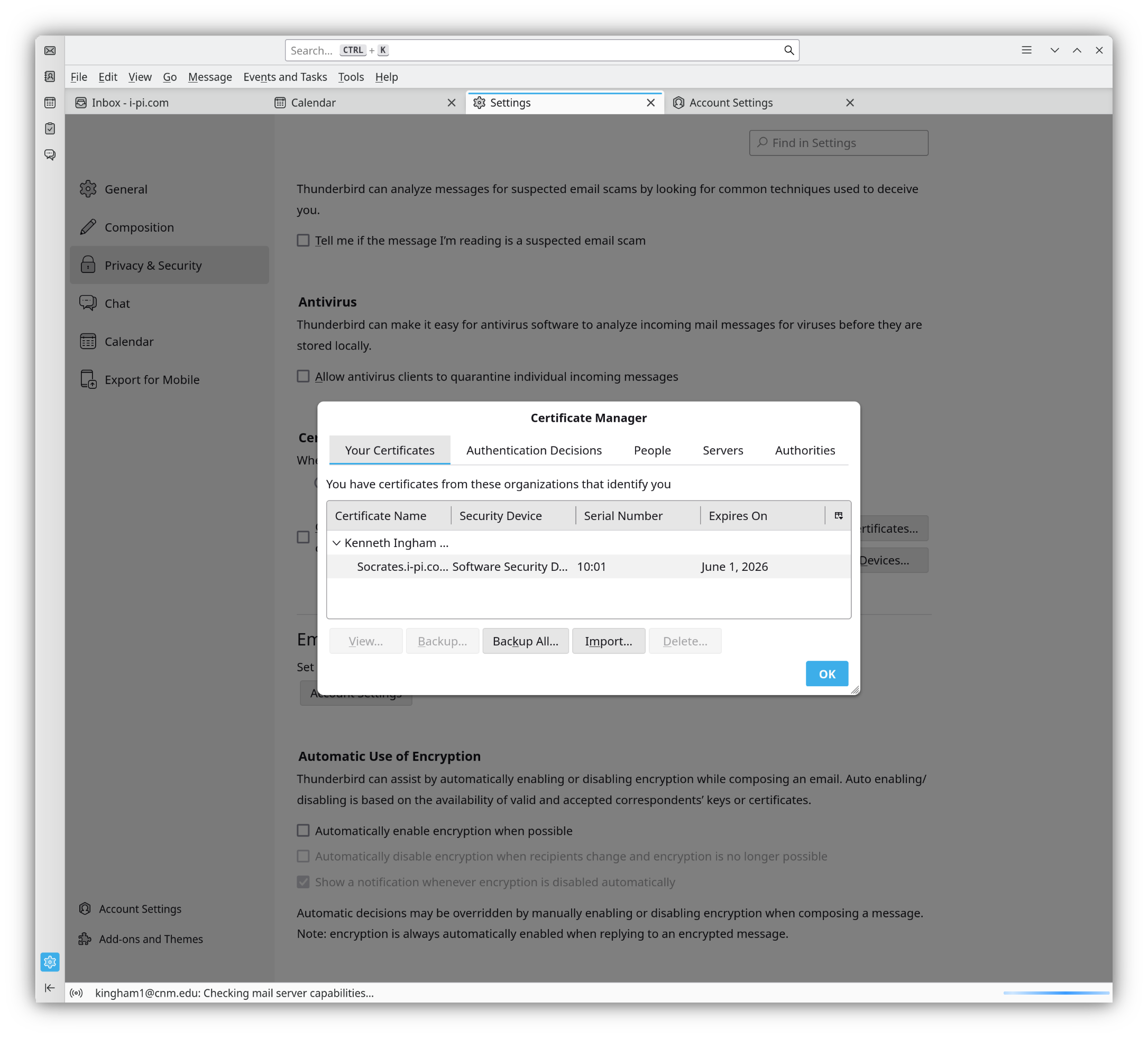

I have added a certificate to the Thunderbird Certificate Manager (localcert.png), with the info as shown in certdetails.png. However, Thunderbird is not sending the certificate. I have "When a server requests my personal certificate" set to "Ask me every time". I also tried choosing "Select one automatically" but that did not change the result.
However, my mail server, which uses TLS client certificates as one factor in sender authentication says: May 27 02:00:05 Mercury2 smtpd[9850]: b972fe936721dfe0 smtp disconnected reason="io-error: handshake failed: error:0A0000C7:SSL routines::peer did not return a certificate"
What am I doing wrong in the config that is causing Thunderbird to not send the certificate?

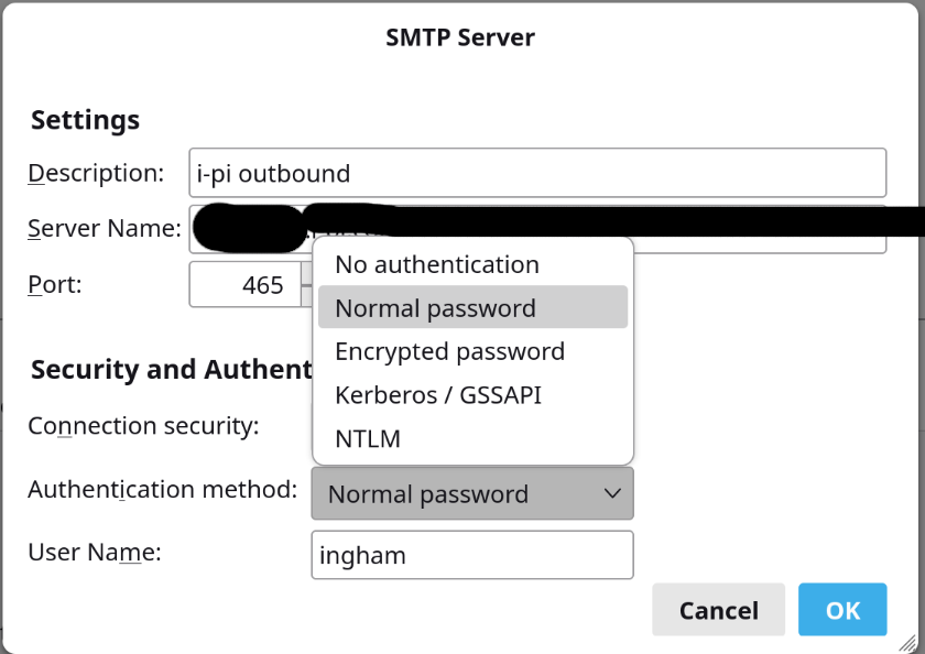

It is not an option for sending mail. See attached authoptions.png. That is a problem to deal with later; one at a time.

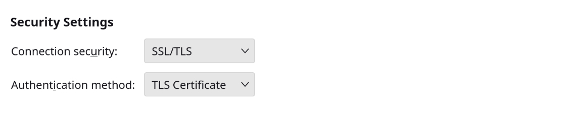

For reading, I have selected SSL/TLS and Certificate (see fetchconfig.png). For "When a server requests my personal certificate:", I have selected "Select one automatically". However, dovecot on the server says: May 30 16:27:57 Server dovecot[19451]: imap-login: Disconnected: Connection closed (client didn't send a cert): user=<>, rip=XXX.XXX.XXX.XXX, lip=XXX.XXX.XXX.XXX, TLS, session=<raSZ5Vw2zrLGMdl5>
When I use OpenSSL with s_client and the same certificate that is in Thunderbird, it connects OK and I can talk to the IMAP server.
